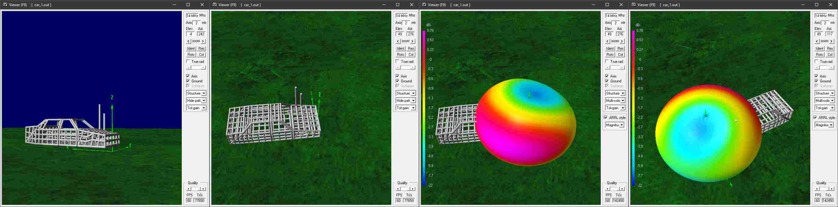

Ok, added the car, the wireframe model is really raw, but it should give you a better idea and... yes, the car has an influence on the pattern, just look at the attached pic which shows the radiation pattern on the 20m band
download/file.php?id=179
HTH !
