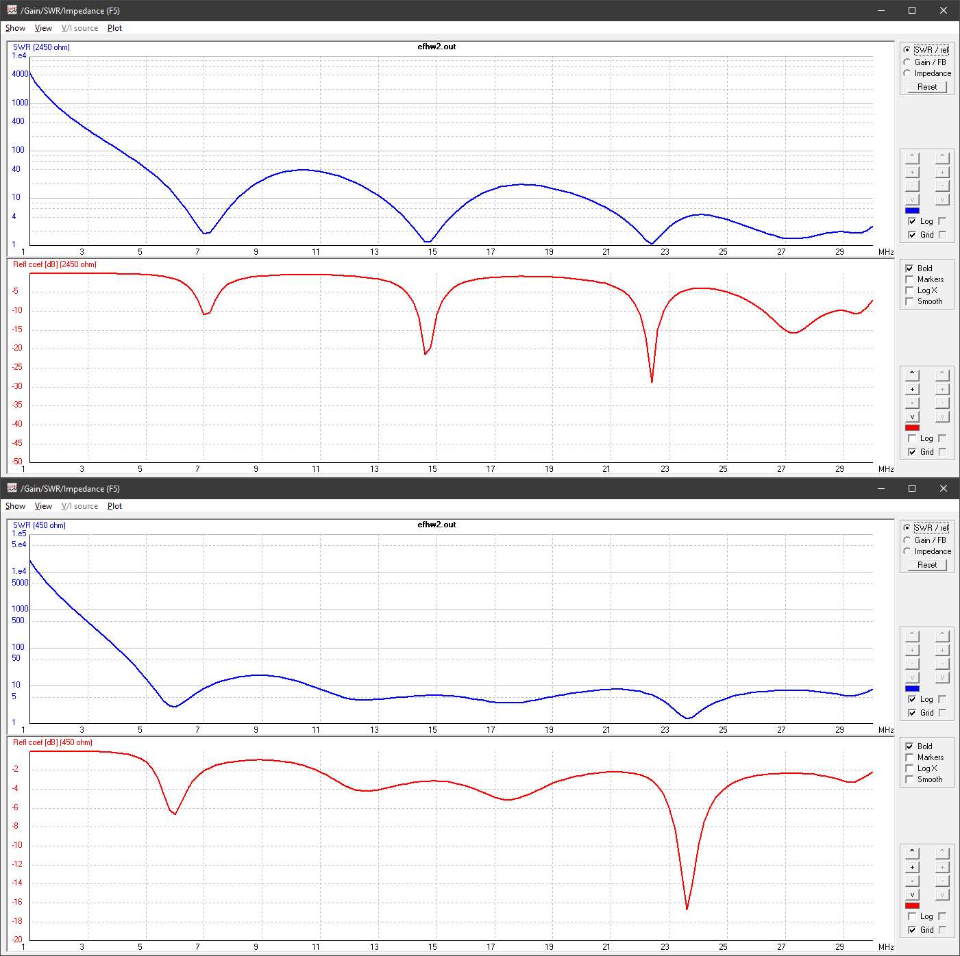

I see your point now, well, I think it may be worth experimenting, if that works then one would just need to change the transformer binding post to the needed ratio and use the same antenna on multiple bands, not just on the harmonic related ones, I'm thinking to model a 40m EFHW (plus a 17ft counterpoise) in 4NEC2 and check the mismatch values, sure that will just be a simulation, but could offer some idea about what to expect
Re: JNC cs-818 tuner
Ok, ran a quick test, built a NEC model with a 1/2 half wave (on 40m) radiator and a 17ft counterpoise, placed the radiator at 20ft meters from ground and ran a sweep from 1 to 30 MHz, then changed the impedance from 2450 (49:1) to 450 (9:1), the results are in the attached image below, the antenna stays under 10:1 from 11MHz up to 30MHz so a good ATU should hopefully be able to find a match, at least on 17 and 12 meters bands, adding some wire to make the antenna longer will improve things (when used as a "random"), same goes for counterpoise, the ideal length (tried it in NEC) when used as an EFHW is 7.2ft, while when used as a "random" it needs the 17ft counterpoise
