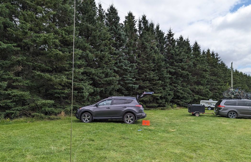

On August 7th 2023 I left home unsure of which park I would try, and resolved to just scout out those with decent vehicle access and space for a good vertical antenna with radials. Tea Hill Park was the first one I visited and it looked promising, so I parked on the edge of a grass field. The weather forecast was for occasional showers, so I decided to set up in the back of my Toyota RAV4 SUV.

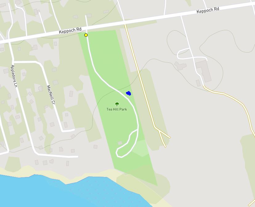

Tea Hill Park is a provincial park, and one of Stratford's most-visited, featuring a cricket pitch that is very popular with our growing South Asian community in the Charlottetown area. There is also lots of room for dog walking, picnicking, and it even has a beach that is popular at low tide. The park faces Northumberland Strait, and on this day the visibility was excellent with a good view of Nova Scotia to the south.
I parked around mid-way between the road and the waterfront, and set about erecting my telescopic vertical antenna and four radials. Using my RigExpert AA-55 antenna analyzer, I found a good element length; giving me an SWR of 1.16 to 1. I ran the 50' RG-8X cable to the back hatch of the RAV4, and started with my 20M QRPLabs QCX-Mini. Settling around 14061 KHz I could hear a few signals, but the QCX was seemingly full of noise. After a couple of CQ tries with no replies, I switched to my FT-817. The band sounded much quieter with the Yaesu, and I packed the QCX away.

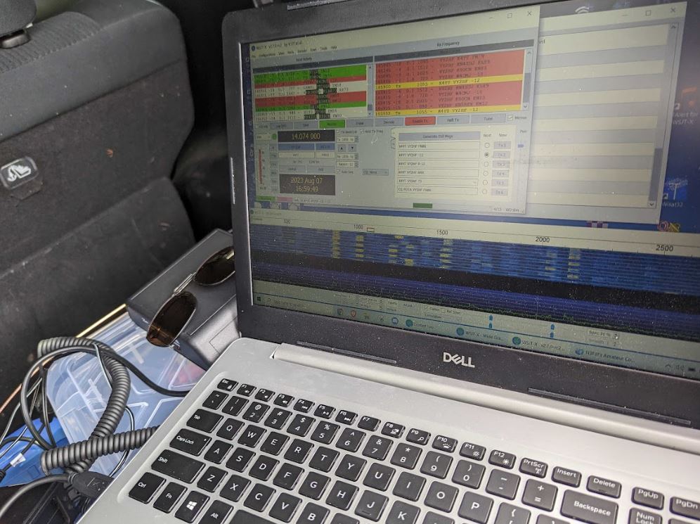

That early luck on CW didn't extend to my next round of CQs down the band. Although I later called up RBN to see I was copied in several states over a three-minute period, I could not hear any replies to my CQs, so I decided to pivot to FT8. I had brought my laptop and DigiRig interface just in case CW was a bust. After a few minutes of setup I put out a "CQ POTA" and immediately got a flood of calls. In the next half hour I managed a dozen FT8 QSOs, interspersed with several periods away from the rig while I conversed with a tourist who had parked nearby.
