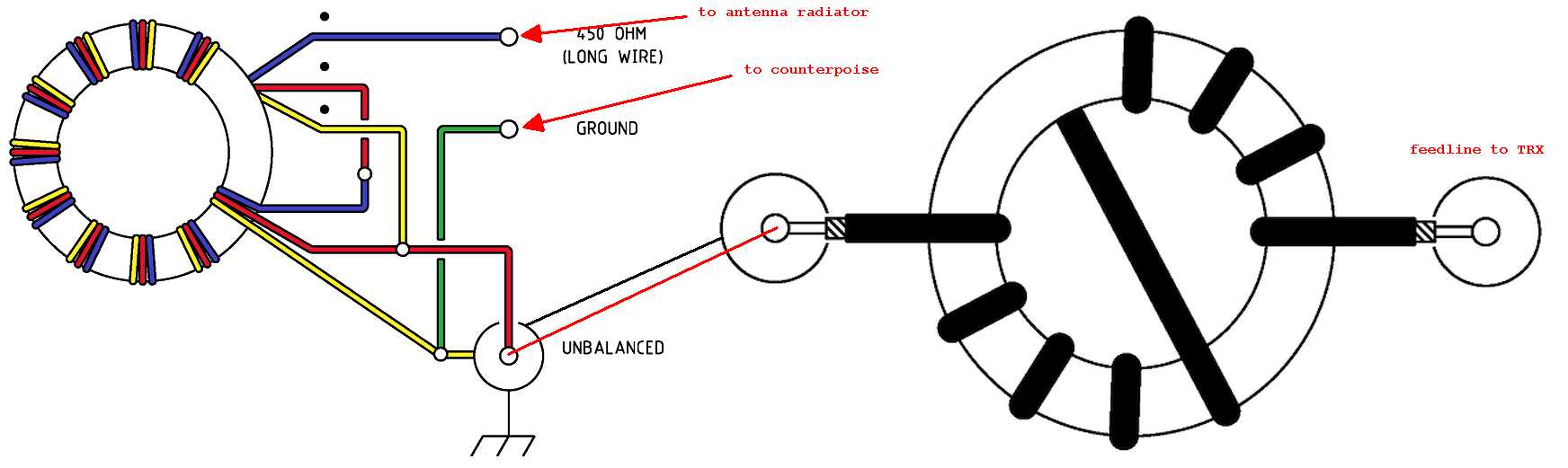

1. You said, ..."that the sequence should be the following: antenna wire -- 9:1 transformer -- choke -- coax -- trx -- counterpoise --" That's somewhat different than what I've been using. The Tufteln EFRW has the counterpoise incorporated at the feed point (pictures here https://www.tufteln.net/listing/1226227 ... -long-wire) to make the following sequence: antenna wire -- 9:1 transformer -- counterpoise (I assume connected to the antenna wire side of the BNC connector) -- choke -- coax -- tuner -- trx. I have no idea if my sequence would change any of your assumptions, but it is different. Comments?
2. Why have the radiator feed point 3 foot above ground and not at ground level?
3. I'll need to do some study/research on the 4NEC2 models before I can really understand what they're telling me. Right now it's like a dog watching TV.
As for the connections (antenna/counterpoise, transformer, choke, trx) look at the attached image which I hope will help understanding the setup I described, regarding the height of the feedpoint you may place it lower, but I prefer keeping it raised even if not so much, then about the 4NEC, no hurry but since you asked about "pattern" and since it depends from how one sets up the antenna, then the solution would be modeling the antenna in NEC and then... it's a "random" plus installed in different conditions at each activation, so the pattern will be somewhat "random" as well :D

Great image...helps a bunch. Are there any advantages and/or disadvantages to having the counterpoise connected to the feed-point ground as opposed to having it connected to the transceiver? What is the ultimate purpose of a counterpoise in a EFRW setup?

KO4RSJ wrote: Tue Jun 20, 2023 11:09 am Great image...helps a bunch. Are there any advantages and/or disadvantages to having the counterpoise connected to the feed-point ground as opposed to having it connected to the transceiver? What is the ultimate purpose of a counterpoise in a EFRW setup?
If you DON'T use a choke, then your whole coax feedline will act as a counterpoise instead of acting as a transmission line, that is, it will radiate and receive RF (which means wasting RF in TX and generally increasing noise in RX), if instead you're using a choke after the 9:1 then the coax won't be able to act as a counterpoise (or at least as a good one), so you will need to connect the counterpoise to the 9:1 ground connection and not to your rig, if you think at it for a split second and focus on the purpose of the common mode choke, the reason should be clear :D

KO4RSJ wrote: Tue Jun 20, 2023 11:09 am What is the ultimate purpose of a counterpoise in a EFRW setup?
Forgot this one, for an antenna to radiate, a current must flow on it, for a current to flow, an equal and opposite current must flow "elsewhere", now this "elsewhere" is some path with the lowest impedance to the RF currents, and lacking another conductor, that is our counterpoise or ground stake, those currents will flow on the external surface of the coax braid, this isn't desirable for a number of reasons, including malfunctions, so we use a choke to stop the coax acting as a counterpoise and, at the same time, we add a proper counterpoise wire to get back in control over the current flow and to make the antenna work the better we can and have the coax feeder only act as a feedline and not as a part of the radiating system
