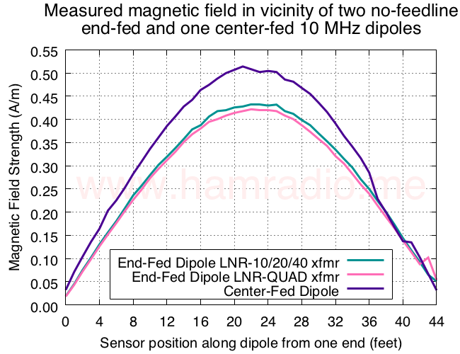

I agree with you on fixed setups and convenience factor. The kite is a out of norm example where just pulling on the coax and bringing the kite straight down fast, to clip on another antenna if needed might offer according to some articles less of a small loss penalty to pay versus a proper transformer to feed a EFHW at its highest impedance point with a result of estimated 1.6dB lower radiated power than a standard half wave dipole per JPEG attached. A bit of increase in efficiency as per JPEG attached helps when using (low power, it all counts). I was generally coming from a increase in efficiency as per JPEG when using low power, using a straight dipole and the (gain in height of 200 feet) or so away from the noise floor with the increase in signal you could work many more stations (faster) on whichever band hi.
