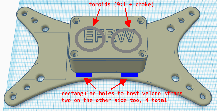

Just to try explaining it better, see the image below (ugly but hopefully "readable")

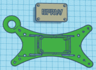

How does this look? The scale is 1cm for major lines.
Re: EFHW/RW - Attaching wire to balun
looks good !
the carabiner hole is useful both when the antenna is deployed and to hang it to a backpack wnen the antenna is wrapped, the velcro stripes will help keeping the wire/coax wrapped
