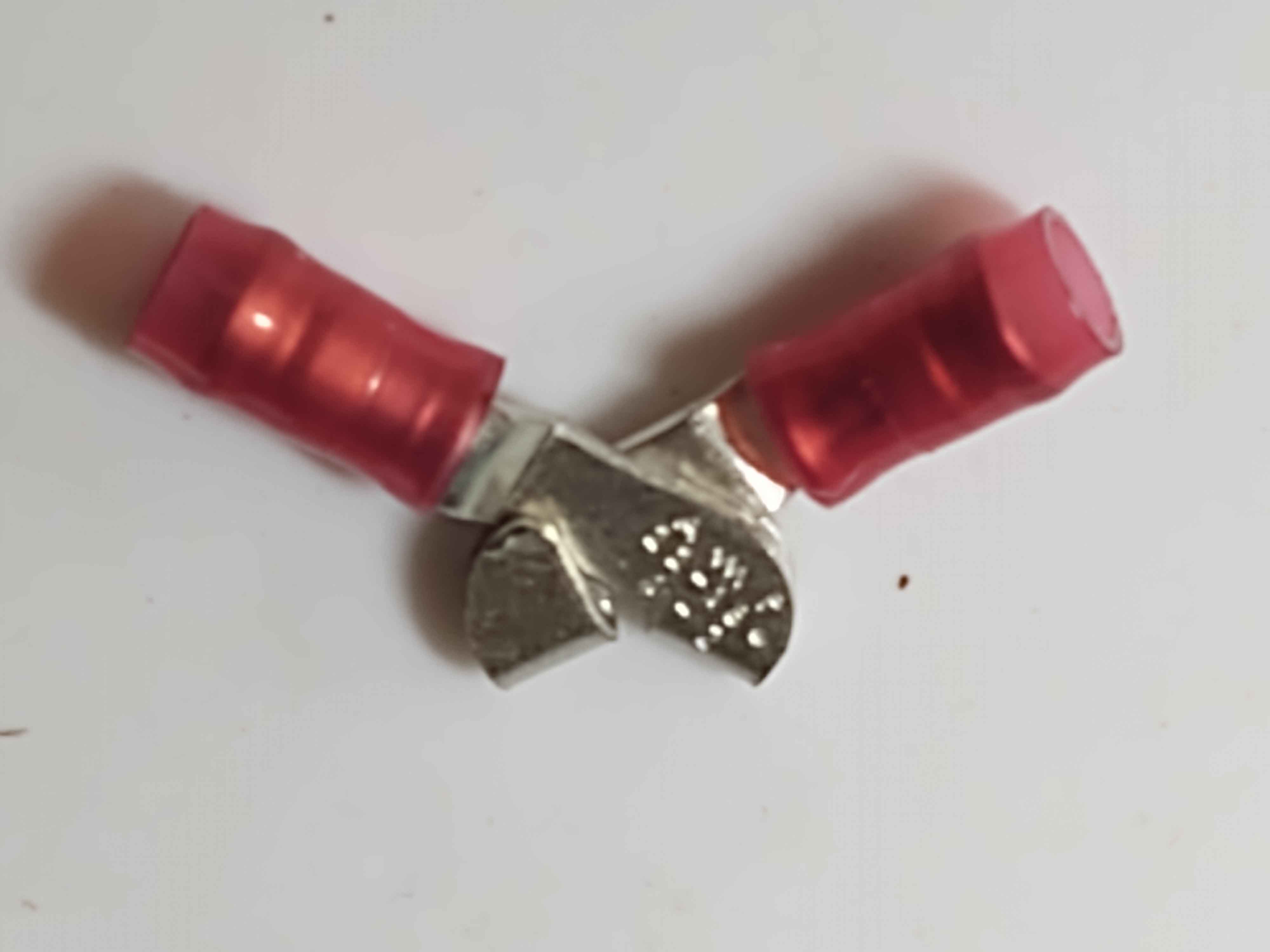

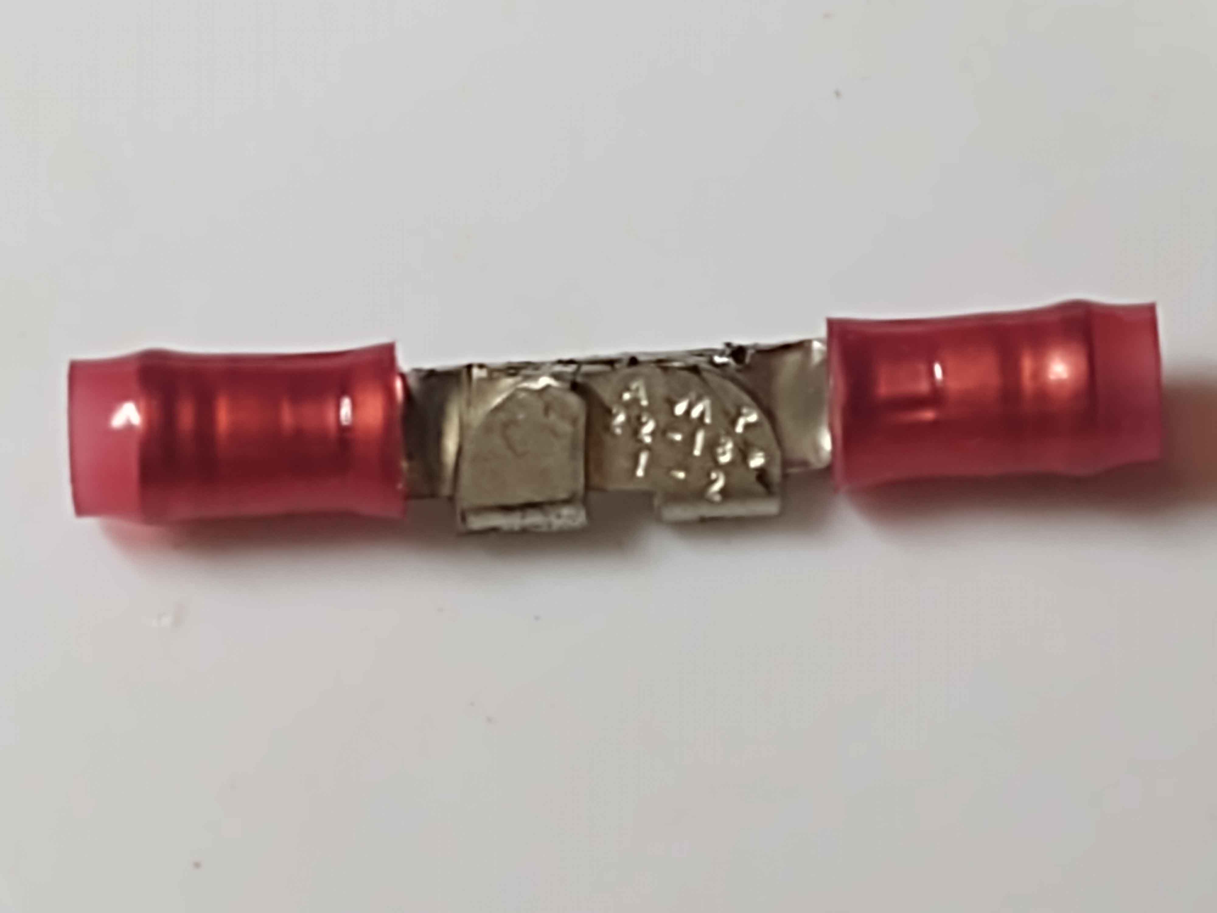

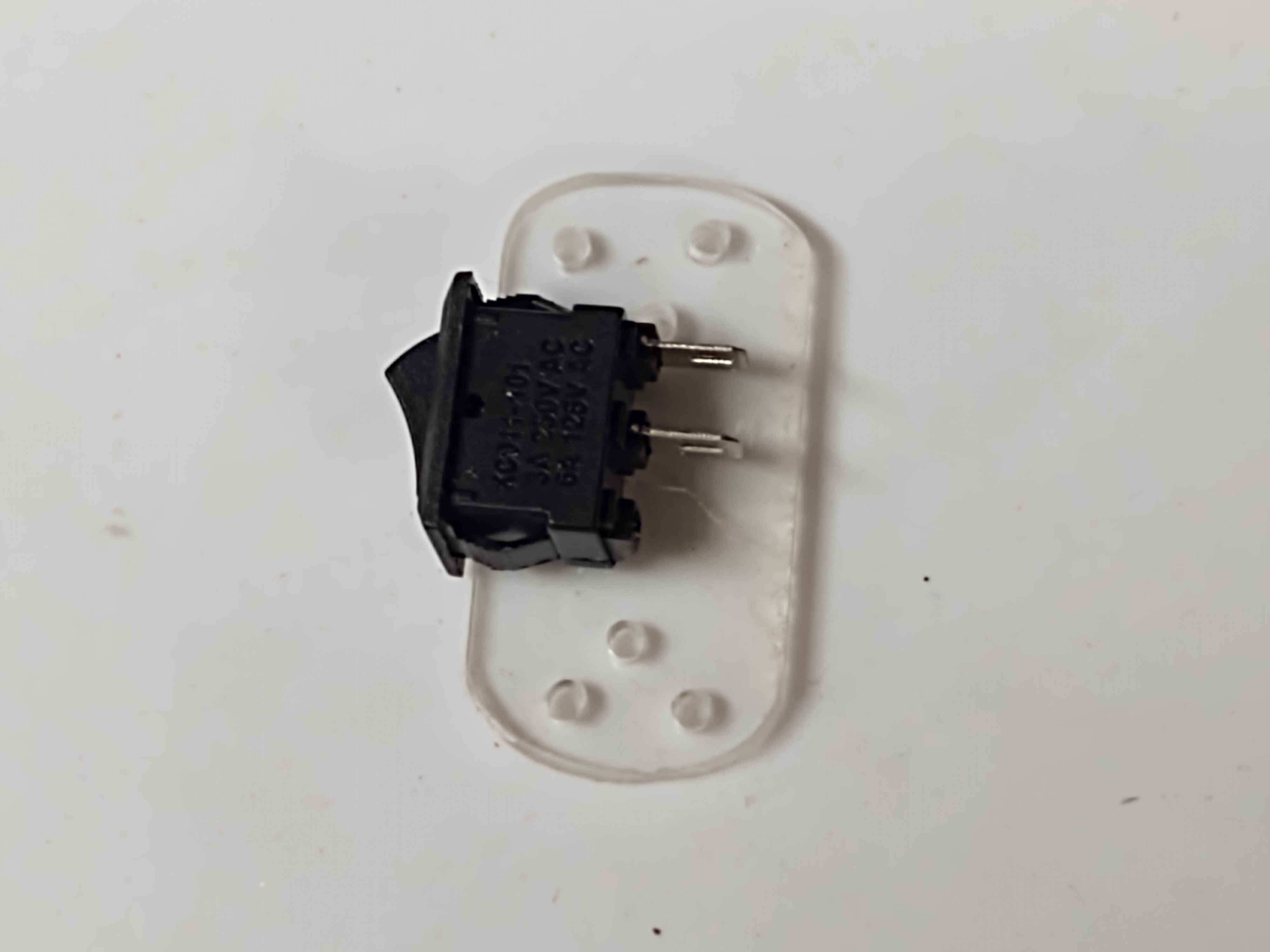

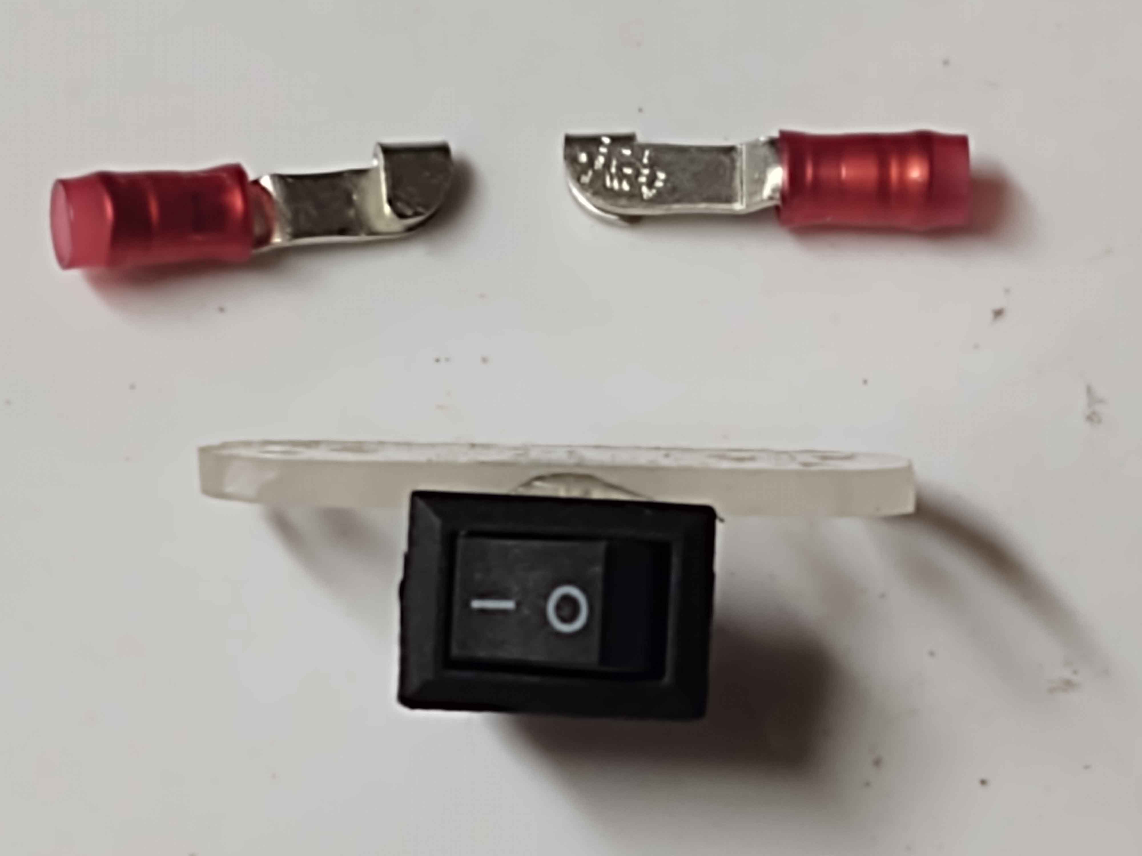

Hi Jeff,
First, whatever link is used, I would be very reluctant to allow it to carry mechanical load. Specifically, deployment and retrieval of wire antennas often requires the wire system to carry load. As such, most electrical connectors require an alternate mechanical link to sustain load independent of the connector.
I have used or seen four types of electrical connections: soldered connections, banana plug connections, PowerPole-based connections, and knife connectors. I have also seen two types of strain relief to carry the load past the electrical connection: links where the wire is woven through adjacent holes, and loops formed in adjacent wire sections that are connected by a carabiner or spring clip.
I have a few pictures that can illustrate some of these concepts:
Switch on Plastic Link with Unlinked Knife Connectors
Switch Link and Knife Connectors.jpg (184.95 KiB) Viewed 20338 times
Plastic Mechanical Link with holes for weaving wire, switch is attached.  Two wires are connected mechanically by the link, and are soldered to the switch, which acts to connect or disconnect them.
Link with Switch.jpg (166.73 KiB) Viewed 20338 times
Knife Connectors positioned to make the electrical connection.

Knife connectors snapped together to make the electrical connection.
Connected Knife Connector.jpg (176.26 KiB) Viewed 20338 times
Hope this helps.
