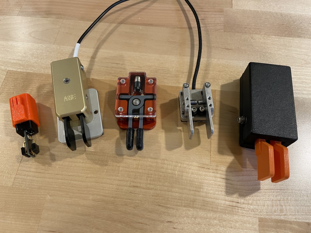

My line up. I tend to switch them up and use them with different radios, but have been used with the TR-35 and work well.
N6ARA TPJ (carry as a backup), AME Ultra Porta Paddle, BamaTech TP-III, N0SA, CW Morse

I have only briefly used a Palm Pico, so I don't think I can comment with any accuracy. The AME Ultra Porta Paddle (note Porta Paddle is different model) is a very nice paddle with magnetic return with good adjustability on the spacing and magnets. It should be noted that the forward adjustment screws on the sides (spacing adjustments) need to be avoided while holding or you will make a contact. You can replace those with recessed allen head screws to solve that. But I tend to dual lock mine onto a little field clipboard.
I like the Ultra Porta Paddle quite a lot, though the BamaTech TP-III is my my favorite and well worth the wait to have one shipped from Germany.
