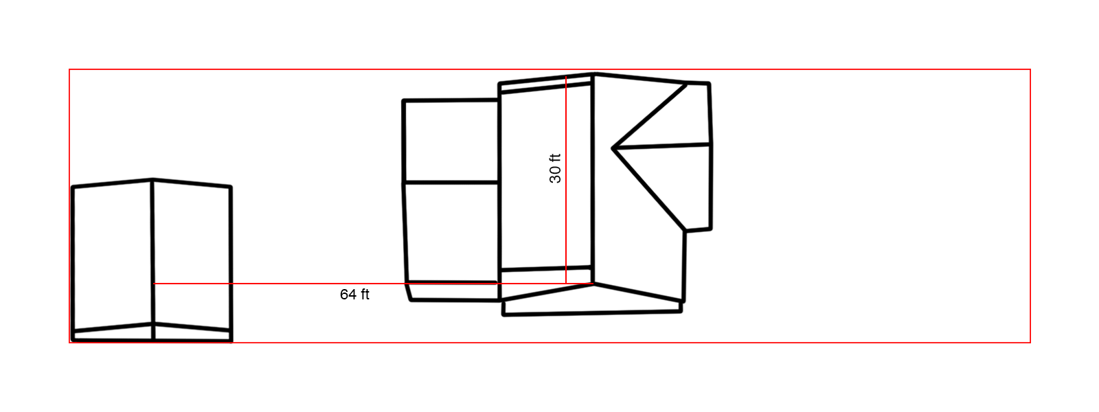

At my own house, my lot is only 40 feet wide and 140 feet long. I could put up a permanent EFHW between my house and garage. The distance between the 2 roof peaks is about 63 feet.

Here is what my lot looks like:

Well, another idea, looking at the image you posted, may be putting up a "skyloop" or "lazy loop" antenna
https://www.dj0ip.de/my-favorite-antenn ... -all-band/
https://www.dj0ip.de/loop-antennas/8-ba ... ntal-loop/
it will just require some supports on the two buildings and notice that it doesn't have to be laid out as a square, for example, this one
http://vu2ppp.com/_sky-loop_antenna
is all but square; sure, the pattern will be less predictable, yet such an antenna would allow you (with an ATU) to cover all bands from 80 up to 10 (and maybe 6) meters with good overall performance

Netdewt wrote: Thu Mar 09, 2023 3:30 pm Here is what my lot looks like:
Well, you may consider this antenna
https://ftp.unpad.ac.id/orari/library/l ... oublet.htm
http://webclass.org/k5ijb/antennas/All-Band-Doublet.htm
place 10ft a support pole at the top of roof and setup a 135ft doublet in inverted vee, feed it with ladder line and connect it to your ATU and you'll have an antenna covering 80 to 10 meters with pretty good performance, and, to bring the feedline all the way to your shack, you may check the idea shown here
http://vk6ysf.com/allbandhfdipole_mk3.htm
that is, run the balanced line as much as possible, keeping it away from obstacles/walls/... then use a balun and a relatively short run of coax to reach the ATU
