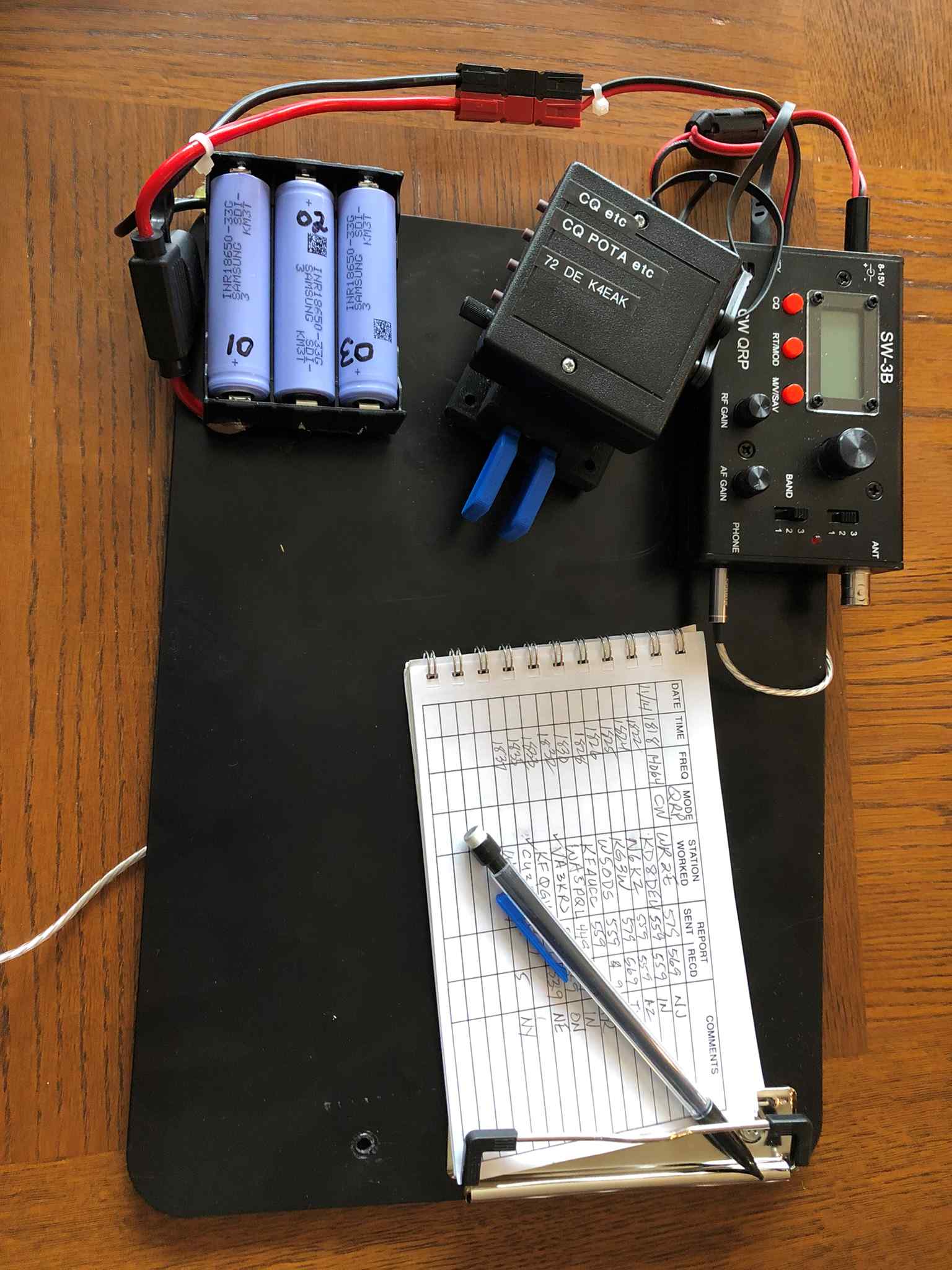

Anyone have experience using 3 or 4 18650 lithium cells in some sort of case? It seems to me that these could be a good QRP option.

Netdewt wrote: Sun Apr 02, 2023 4:55 pm Anyone have experience using 3 or 4 18650 lithium cells in some sort of case? It seems to me that these could be a good QRP option.
That's what I used for a while. Easy, inexpensive way to get 3 AH in a small package. Only downside is that Ii didn't use a BMS so I had to take out the batteries to charge them.

I stayed with AA Nimh cells, since I already had them and the charger. They will last me for at least 8 hours of radio time. It gives me the option of buying alkalines at a trail-side store if I need to. I also carry a 9v transistor radio battery for backup.

I'm convinced you've done it all, Skip. I decided to to the Talentcell, realized that it is just 18650 batteries with a BMS and charger for $28. Should arrive Monday and need to build antenna. We've had wild weather. Snowstorms last week, 80s this week.
