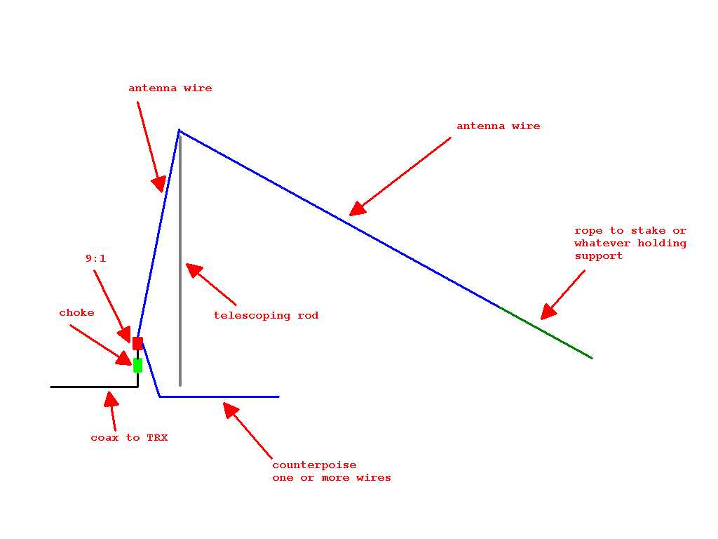

Good news, now consider making your radiator wire a bit longer, not too much by the way but if you can, with a 71ft (21.64m) wire you'll be able to cover all bands from 80 meters up and that will still be a pretty manageable size, for example such an antenna could be laid out as an inverted L using a telescopic rod and with the wire sloping away from the rod, see the attached image (no artwork) to have an idea
