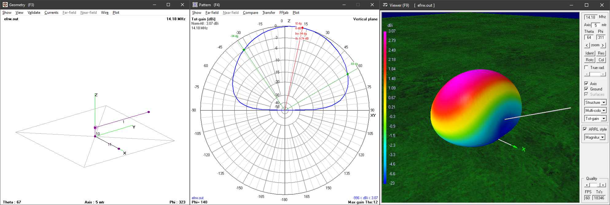

Yes, what I mean is that the "sequence" should be the followingKO4RSJ wrote: ↑Mon Jun 19, 2023 11:35 am Andrew...great (and very useful) explanation on uses of the common mode choke. Question to make sure I'm understanding your correctly: when you say "...I believe it's better setting up a choke after the 9:1 transformer." I take this to mean that the choke goes on the end of the coax (feed line) just before it connects to the transformer/radiator. Is this correct?
I'll definitely pickup a copy of 4NEC2 and add that to my tool box as I try to make sense of all this antenna magic.
antenna wire -- 9:1 transformer -- choke -- coax -- trx
counterpoise ----------^
as for placing the choke, it may be right after the 9:1 or placed at some spot along the coax or even near the trx, even if placing it right after the 9:1 is usually a good setup, as for 4NEC2, don't be fooled, sure maybe the learning curve isn't exactly flat, but I think it is really a useful tool
Code: Select all
' file comments
CM efrw.nec - simple random wire antenna model
CE
' base symbols
SY freq=14.175 ' test frequency
SY leng=10.668 ' radiator wire length
SY cpse=5.1816 ' counterpoise length
SY wire=0.00075 ' wires radius
SY hfed=1 ' feedpoint height
SY hend=6 ' endpoint height
SY segl=51 ' segs for long wires
SY segm=21 ' segs for mid sized wires
SY segs=5 ' segs for short wires
' pythagorean formula
SY sidA=abs(hend-hfed) ' vertical side of triangle
SY sidB=sqr((leng^2)-(sidA^2)) ' horizontal side of triangle
' counterpoise calculations
SY spcr=(wire*3.5) ' ground spacing (NEC needs it)
SY hlow=spcr ' low point of counterpoise
SY lenv=(hfed-hlow) ' vertical counterpoise len
SY lenh=(cpse-lenv) ' horizontal counterpoise len
' feedpoint
SY fwir=1 ' feepoint wire #
SY fseg=1 ' feedpoint segment #
' radiator wire geometry (wire# segments x1/y1/z1 x2/y2/z2 radius)
GW 1 segl 0 0 hfed sidB 0 hend wire
' counterpoise wire
GW 10 segm 0 0 hfed 0 0 hlow wire
GW 11 segm 0 0 hlow lenh 0 hlow wire
' end of geometry and ground parameters
GE 1
GN 2 0 0 0 13 0.005
' wires loading (copper)
LD 5 0 0 0 58000000
' enable extended kernel for FP calculations
EK
' place the feedpoint
EX 0 fwir fseg 0 1 0 0
' initial test frequency
FR 0 1 0 0 freq 0
' end of model
EN
- Attachments
- efrw.jpg (114.19 KiB) Viewed 69045 times
Re: Best Practices for an EFRW Setup
Andrew...that post really got me thinking! I've got some questions/comments.
1. You said, ..."that the sequence should be the following: antenna wire -- 9:1 transformer -- choke -- coax -- trx -- counterpoise --" That's somewhat different than what I've been using. The Tufteln EFRW has the counterpoise incorporated at the feed point (pictures here https://www.tufteln.net/listing/1226227 ... -long-wire) to make the following sequence: antenna wire -- 9:1 transformer -- counterpoise (I assume connected to the antenna wire side of the BNC connector) -- choke -- coax -- tuner -- trx. I have no idea if my sequence would change any of your assumptions, but it is different. Comments?
2. Why have the radiator feed point 3 foot above ground and not at ground level?
3. I'll need to do some study/research on the 4NEC2 models before I can really understand what they're telling me. Right now it's like a dog watching TV.
