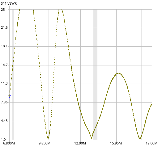

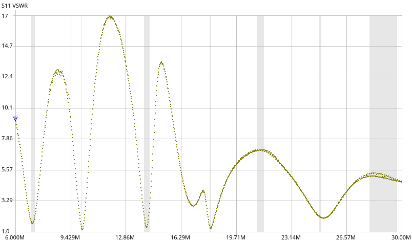

So I decided to build a trapped EFHW to find out...
My design was a 4-band EFHW - 17/20/30/40. I used three traps from SOTABeams.co.uk (17, 20 and 30m traps). My first design used wire cut for a half wavelength for each band:
17m - 26 feet
17m trap
20m - 7 additional feet
20m trap
30m - 9.5 additional feet
30m trap
40m - 24.5 additional feet
and this was what that gave the first plot below.
- Initial antenna
- 4befhw_1.png (11.56 KiB) Viewed 25616 times
I spent the rest of the day tweaking the settings, and I learned several things:
Traps lower the resonance of the antenna, so you have to shorten the wires.
The 20m trap was necessary (I removed it and quickly replaced it - the final "natural" resonance was around 17MHz).
You set the resonant point for each band by adjusting the trap, and you adjust the SWR by adjusting the length of the wire.
When all was said and done, the second plot below shows the final antenna. Once everything was tuned, I coated all of the splices and traps with liquid electrical tape - and rechecked the SWR and didn't see any change.
- Final antenna
- 4befhw_final.png (14.82 KiB) Viewed 25616 times
The one thing I would do different is that I would have ordered a bunch more trap kits - I only ordered two, but I expect that I will use them a lot in the future. The kits are inexpensive but shipping isn't!
Mike, KL7MJ/4
Re: Trapping the EFHW?
Posted: Wed Jul 12, 2023 3:54 pm
So you did lose the resonance on 15 and 10 meters.
Thanks for going thru all the work to find this out, Mike. Your efforts are appreciated and I learned something!
Posted: Wed Jul 12, 2023 5:05 pm
by KL7MJ
Yep, the shallow dip around 16.5MHz is the untrapped 20m dip.
