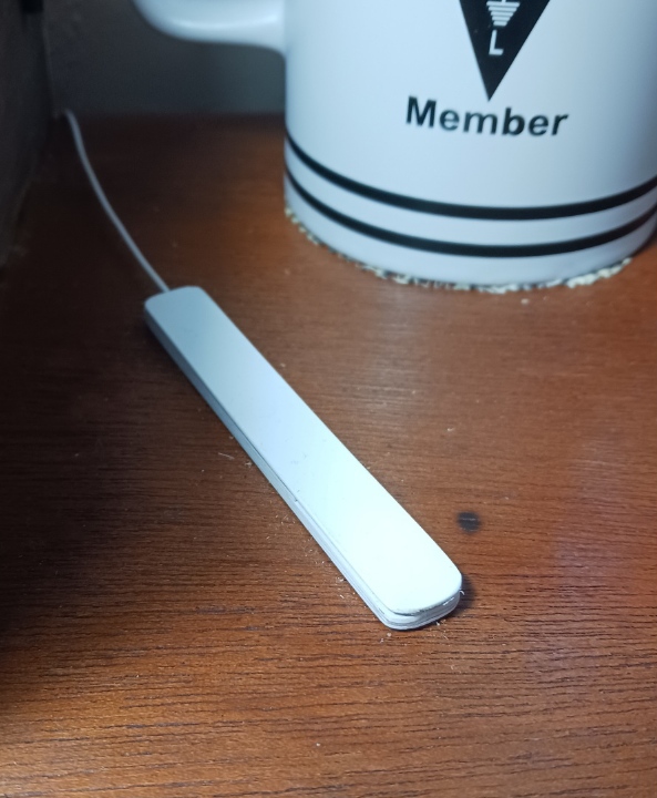

I couldn't find anything I liked, so I experimented and built my own. This is
about the 5th version. No adjustments needed because I built to my specs.
It's made from copper foiling tape, an old g(ift card and an old earphone wire and plug.

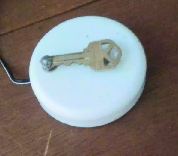

Here's one I built with my grandson. He looked at my straight key one day, and said, "Why do they call it a key? It don't look like a key to me".
So we took one of his play keys, a plastic box he got with candy in it, a couple of small bolts and built this.
We were gonna add a small oscillator inside so he could practice, but he lost interest before that happened. We built it when he was 8 and now he's 20!
I have used it as a portable key often thru the years. It works well and is pretty indestructible.
Have fun!
