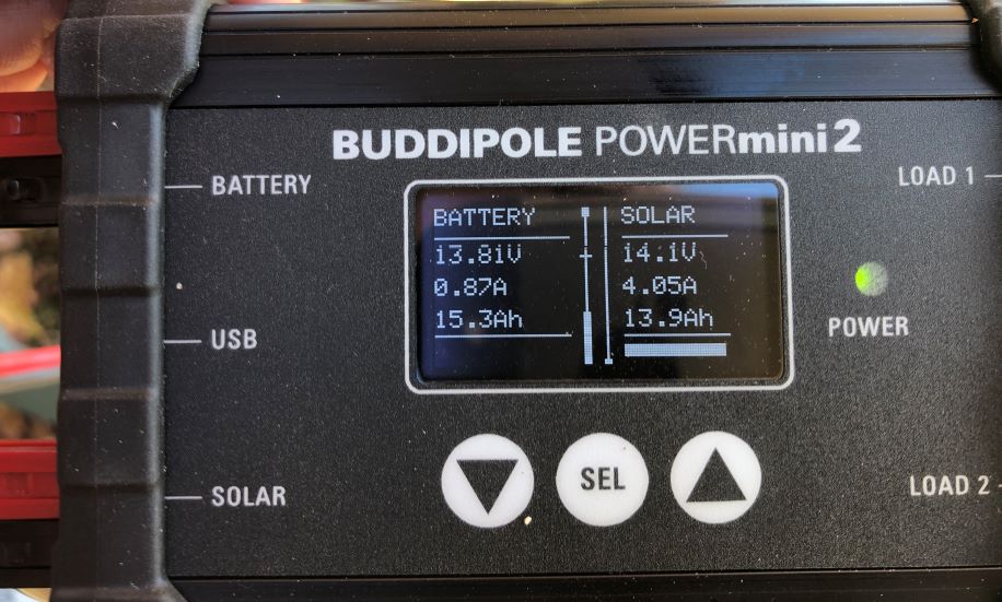

I don't have a lot of experience, but I do use a cheapo 100-W solar panel from time to time and it's really surprising to me what a nice complement it can be, especially operating QRO. During a recent POTA "sprint" contest, over the course of 4 hours operating QRO (mixture of 60W-CW and 90W-SSB), my IC-7300 consumed 15.3Ah of power and the solar panel returned 13.9Ah, for a net consumption of 1.4Ah (or 350mAh/hr).
The panel (when I checked the totals--see above) was only putting out about 60W, although I think most of the decrease from the rated value was because the LiFePO4 batteries were still pretty much fully charged.
Anyway, more experiments are planned.

I just realized that I forgot to put the baseline power consumption in my post above. I've found that, when operating QRO, with my mix of operating (YMMV), I plan on about 5Ah consumption per hour of operating. Thus, my 40Ah battery box (two 20Ah LiFePO4 batteries in parallel) will comfortably get me 6+ hours of operating (without solar replenishment).
QRP operations, obviously, are another story. For that, baseline consumption runs around 350mAh per hour, so even a small battery (like the 2.6Ah battery in the KX2) likewise will last 6'ish hours, certainly enough for 3 short POTA activations.
