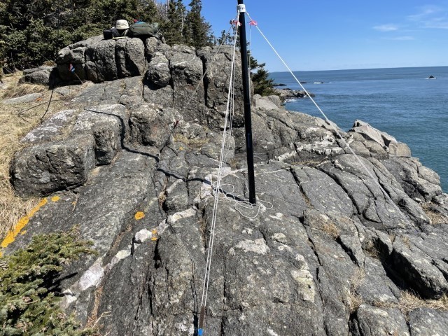

I do quite a bit of stuff on rock only areas, be it shoreline or mountain top, and I almost always use either a 16' or 23' telescoping mast for a support. I tend to use home made linked dipoles, but the mast can just as easily work with an end fed. It depends a bit on the geology of the area, but in most places in the northeast (and most places that I spent time out west too), the rock offers enough features to find natural anchors to support a telescoping mast. It takes a bit of exploring to find an ideal spot with potential anchor points (meaning cracks) located such that my three mast guy lines have good geometry to support the mast.

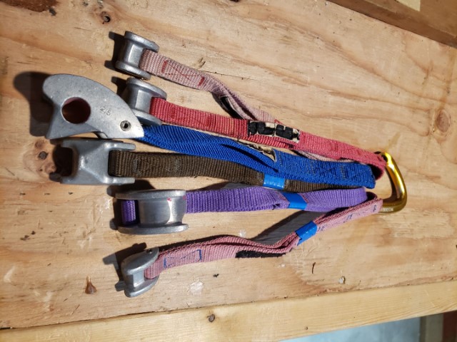

Sometimes you luck out and find natural horns, large surface stones or flakes you can tie a guy line too directly, but I very often use retired rock climbing protection for the points. It would be very easy to make some homebrew gear that would work the same way, or buy some old climbing gear on the cheap. I tend to carry a handful of tricams (pictured below), because they are simple, light and also offer a range of crack sizes per piece. Some different sized machine nuts with cord threaded through them could easily work well in many places. However, if you are dealing with featureless rock, then this is all useless.
Ocean side bluff top setup with SOTABeams 7000HDS 23' mast:
IMG_1153 (Small).JPG (151.02 KiB) Viewed 28805 times
Tricams (I usually only carry the smallest 4 sizes)
