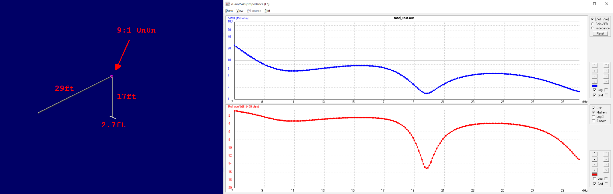

Ok, had some free time and modeled it using 4NEC2, the results are in the image below (full size here)
the antenna has a radiator length of 29ft and is placed horizontally at 17ft from ground, a counterpoise drops from the feedpoint (9:1 UnUn) to ground and there is connected to two 1.37ft wires forming an inverted T (about 2.7ft overall) laying on ground, the coax drops down from the UnUn along the vertical wire and at its bottom there will be a 1:1 choke and the coax will then run toward the rig; the resulting antenna should have an SWR curve similar to the one visible to the right of the pic, which should be ok for most ATU units
By the way, that's just a simulation, so the real thing may/will vary
