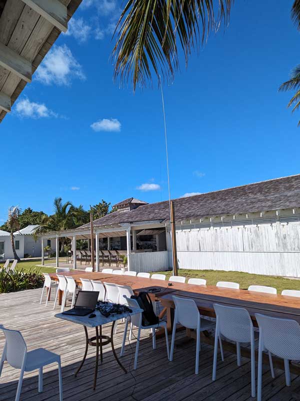

Setup was to bungee cord the travel mast to a convenient post, pull a table into the shade, set up antenna and radio, and get going.

This is a view of my setup.

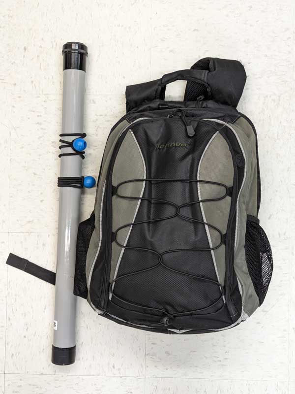

The whole station, except the travel mast, fits in this laptop knapsack:
