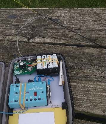

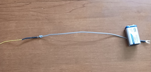

My antennas are usually 26 or 28 gauge wire. I add 30 to 40 cm of heavier wire at the transformer end to compensate for the rough handling and bending it can be subject to. Remember this adds to your antenna length, so you have to subtract that length from the far end of the wire.
I tie a knot in the heavy wire on the transformer side of the splice. A string or rope tied around the wire In front of the knot can be run to a stake in the ground or somewhere on the table to take the stress of the wire. Then the end of your antenna is loose and needs no hard connection. A croc clip or just wrapping the wire around the post can work.
Your antenna wire doesn't have to be stretched "fiddle string" tight to work. My antennas droop a lot when up in the air. The one in the pictures is at least 5 years old and hasn't needed any maintenance at all.
GL n 73
