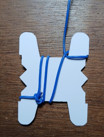

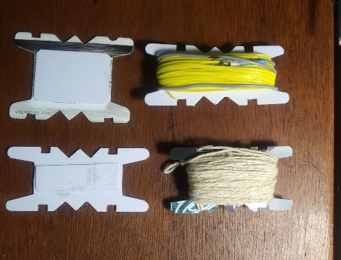

I devised a winder frim an old gift card that lets me lock the wire at any length. I put knots at the resonant points of the wire so I can work any band.
The points allow the wire to spin off very quickly. The "ears" and notches catch the half- hitch knot I lock the wire with.

Rick: those gift cards are brilliantly cut!
Please forgive my ignorance: I understand keeping some windings on the card depending on the resonance you want for the antenna. But how do you make the connection to the radio? I'd be leary of hosting the winding card with the extra wire up into a tree lest it be more likely to catch on a branch. But I don't see a connector or even a long lead for connection in your example photos.

Re: How do people organize/store wire antennas
Posted: Tue Jun 04, 2024 8:19 am
Todd
The winder is always at the far end of the antenna.
Most of the time, I use a telescoping pole. For the times I'm forced to use a tree, I just throw the near end of the wire over from the opposite side of the branch. I really hate using trees in public parks.
My wires are light enough to use cotton kite string to pull them up or tie off the far end, using the winder as an insulator. That way it will easily break if caught in a tree. It will also decompose much faster than man made fibers would.

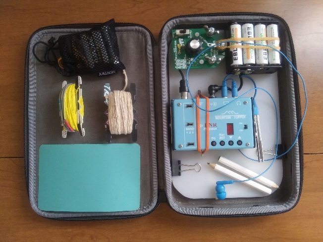

The 64:1 transformer is mounted on a board along with the radio. Everything but the antenna wire always stays connected. It's easier on the connectirs, and I can't lose or forget anything.

Thanks, Rick. That's a clean, well-designed operating kit! Lots of good ideas in there.
