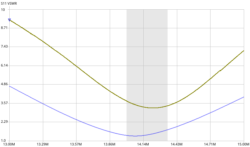

I've seen several videos lately extolling the virtues of a faraday cloth, aka magic carpet as a replacement for radials. So for about $10 I bought a 44x108" faraday sheet.
I tried several configurations of a short base loaded vertical (6' antenna and base coil on a small tripod). I tried the antenna sitting on the cloth, connected by a jumper, connected by a jumper with a tuned radial, and finally with just the tuned radial. In short, without a connection to the cloth had high SWR, connecting it with a jumper lowered it to about 3:1, adding the tuned radial reduced it to about 2.5:1, and removing the cloth and just using the radial lowered it to about 1.3:1.
In this graph, the antenna with the jumpered cloth is the green trace, and the antenna with the tuned radial is the blue trace
Has anyone else tried one of these? If so, how were your results?

I haven't tried a Faraday cloth but I have experimented with many different kinds of counterpoise/radials. I found there is interaction between the lenghts of the whip and the radials. Did you re-adjust the loading coil or whip length after connecting to the Faraday cloth? In one of my experiments I stretched the vertical element way beyond its usual resonant length and used very short raised radials to bring it back to resonance - it works. The length of radials laid on the ground also affects tuning, although not to the same degree as raised radials.

So a little more detail on my experiment.
I had the antenna sitting on my deck, which is about a foot off the ground.
The radial is about 16 feet long, and I laid it along the deck and onto the (clay) ground. About 10 feet was on the ground.
The first test I did was to place the antenna on the screen without a connection. It showed SWR inflections around 13MHz and 18MHz. Once I connected the ground screen or the radial the pattern was for a single inflection in the 20m band.
I didn't try to adjust the antenna for the ground screen in this chart, but adjusting the length of the antenna whip only moved the frequency up and down, it did not improve the SWR.
I designed the antenna to be resonant on 20m. If I have to significantly change the dimensions to make it work with the ground cloth I'd imagine I'd possibly get a lower SWR but at the cost of efficiency (which already isn't great in a 6 foot tall antenna).

Great writeup, Mike! I appreciate your time and efforts.
I wonder if adding a few more jumpers to the faraday cloth at different points would change anything? Maybe the fabric isn't very conductive.

Rick,
Ok, I did a little more testing that I left out...
Adding a second jumper raised the resonant frequency but did not improve the SWR. Using both the cloth and a radial was better than the cloth alone, but worse than the radial alone.
I'm working on a homebrew PAC-12 antenna, and I'm hoping that a little bit bigger antenna might work better. As it stands now, I'm not overly impressed with the magic carpet. Glad I only paid about $8 for it!
