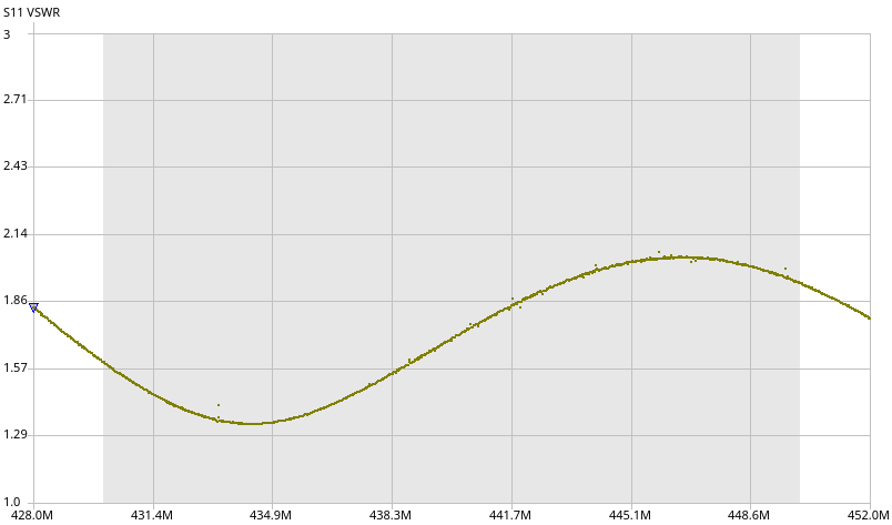

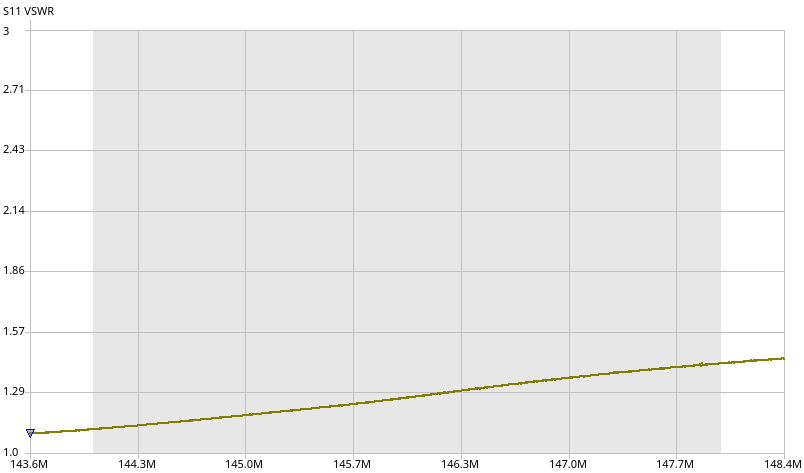

I've been building and using J-poles for over 30 years, and my favorite travel antenna for 2m/70cm was a J-pole made out of 300 Ohm twinlead. This is now my favorite travel antenna for my HT.
The price listed on the website is $70, but I built one for about $20 with faraday tape and ribbon that I bought online.
So far, it works great! I definitely am able to reach repeaters that I couldn't before, and it rolls up into a tiny roll, maybe 2"x4"x1" - the RG-174 coax that I use with it is a larger bundle.
If anyone is looking for a J-pole for their go kit, this is a great idea!
P.S> Here are the SWR plots for 2m and 70cm:

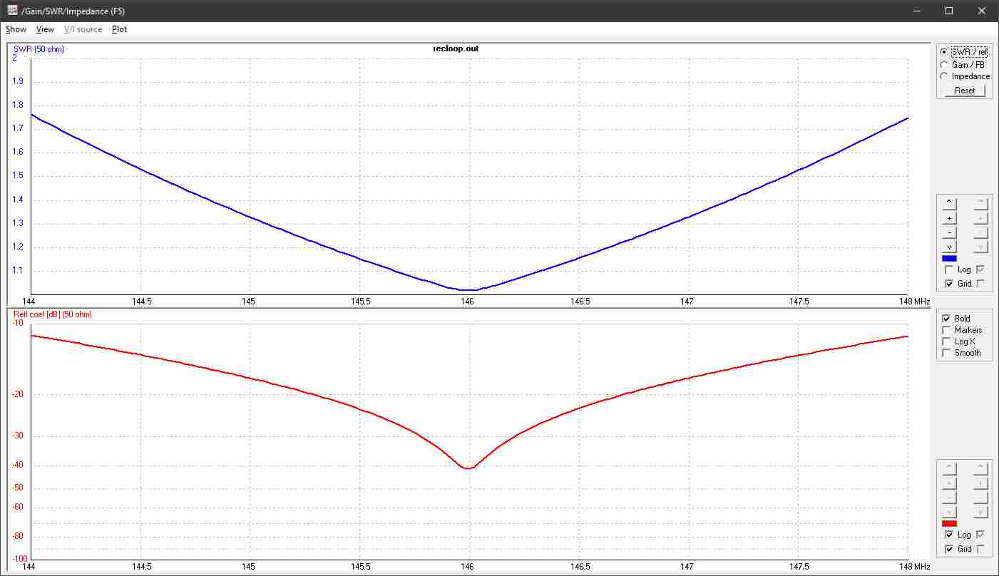

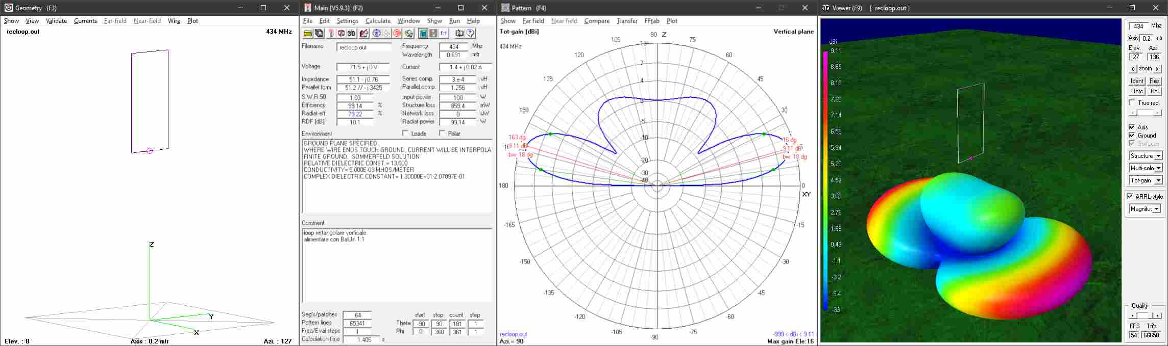

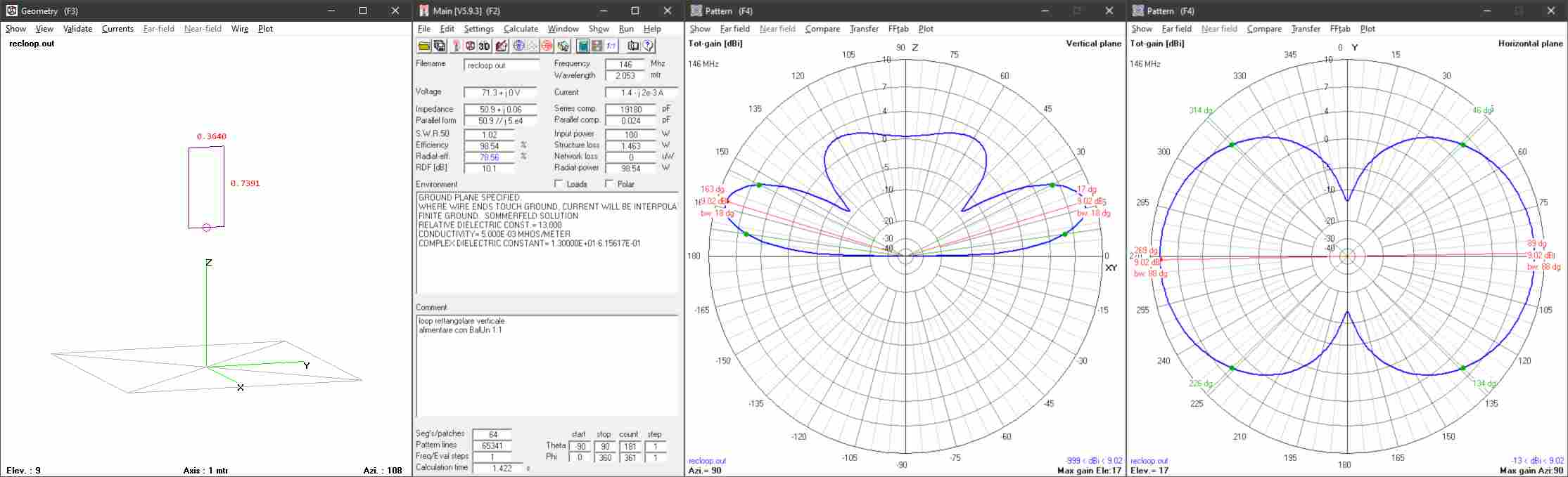

Just in case, the images below shows the "oblong loop" recalculated for the 2m band, sizes are in metric units, the model is for an antenna built using teflon insulated copper wire with 1.5mm diameter, and they should be used as a coarse indication, recalculating them won't be a problem, I think
download/file.php?id=180 the antenna is calculated for a centerband of 146MHz and the "SWR bandwidth" extends from below 144MHz to above 148MHz with a bidirectional lobe offering a gain of more than 9dBi and low takeoff angle
download/file.php?id=181 it may probably be built using the same approach of the one used for the J-Pole but offering much higher gain, although it won't be omnidirectional like the J-Pole, but that could be an advantage, I think
