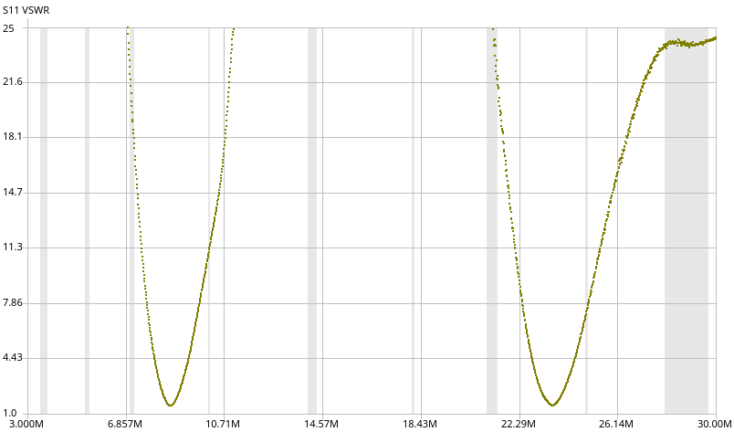

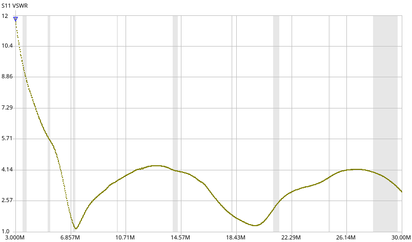

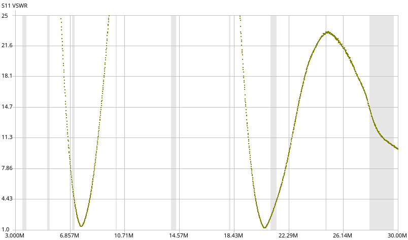

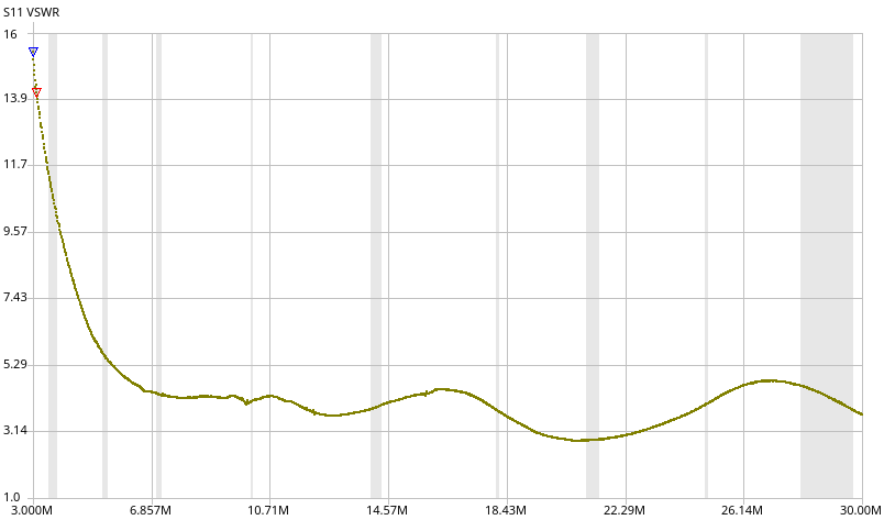

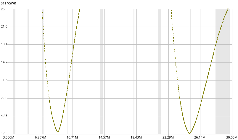

Here's what I got from 3 different EFHW setups this weekend
First a 35.5/17 with a 9:1 unun:

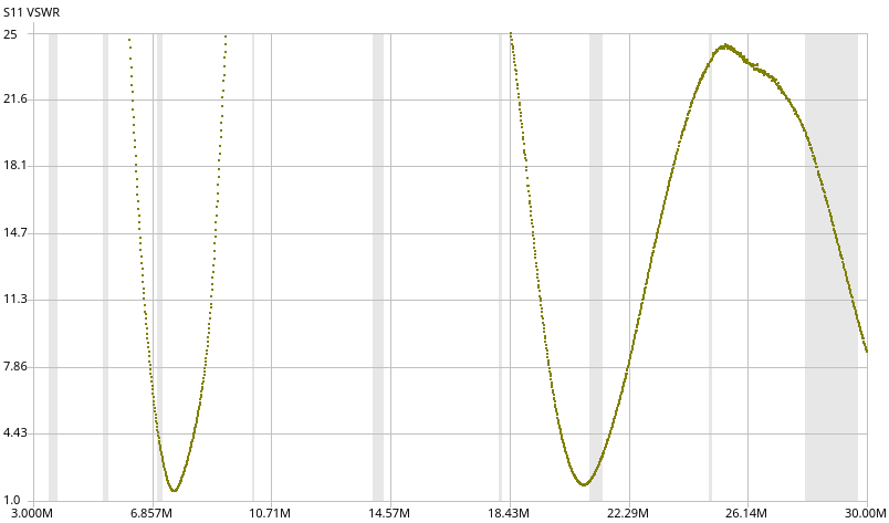

Then a 35.5/17 without an unun:
Finally a 29/17 without an unun:

KL7MJ wrote: Tue Oct 08, 2024 10:18 am Here's what I got from 3 different EFHW setups this weekend
Interesting, but having the R/J (resistive and reactive) values and/or the impedance value would have been more useful, since with that one could be able to find out a better tranformation ratio for the UnUn, just to make an example, playing with NEC, I found that at some radiator lengths, a 16:1 UnUn (800<->50 Ohm) gives a pretty "flat" SWR curve :D

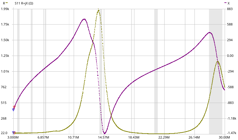

35.5/17 with Unun

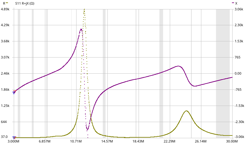

35.5/17 without Unun
