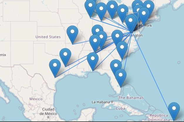

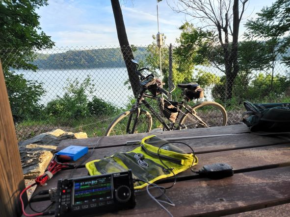

I like to incorporate hiking and POTA/SOTA activations as much as possible. Now that summer is finally here in Pennsylvania, I also enjoy bicycle riding. I've been working on different ways to incorporate both, and I recently saw a video of someone on YouTube doing a bike activation. That got the wheels spinning for me, and I tried it and had a blast. I have an old Cannondale bike and hooked a mirror mount antenna to the bike frame and for 20 meters attached my 17 ft. MFJ whip antenna and used four 16 ft. ground radials. I had a perfect 1:1 SWR on 20 meters in the CW portion and worked several stations using my Xiegu x6100. I then went to 40 meters and used my 40 meter Hustler antenna on a small pole and took the four ground radials and connected them together to make two 32 ft. ground radials. So on 40 meters CW I had an almost 1:1 SWR again and made a bunch of CW contacts as well.
Carrying the equipment in a backpack while riding is okay, however I decided to get a luggage rack for the back of the bike and a bike bag to store my portable equipment in. I hope to do my maiden voyage with that tonight. I might have to carry the antennas since they will be longer than the luggage rack on the back, which is no problem, because I won't be carrying much weight in the pack now. I permanently mounted the mirror mount to the back of the rack as well, so only need to put out the ground radials and set up the antenna and away I go. Below is a picture of when I was set up on 40 meters at K-4567 in PA along the Susquehanna River. I also have a very short video of my set up if you click on the link for my very small YouTube channel that I store things on. https://youtu.be/HsJyZbQmvrk

Hey Scott.. that looks like a great set up.. I like how you attached your antenna to the frame.. and Look at that QSO map, WOW.. I'd say you have successfully made your BOTA rig work very well.. Congratulations and thanks for sharing.. 73, Kevin ~ k0klb

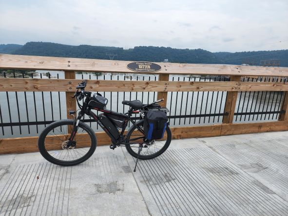

I just upgraded my POTA bike and I've joined the world of eBikes. I've had the bike for just over a week and have over 100 miles on it. Took the bike to activate POTA on Sunday and it worked out great. This is a "starter" bike, to see if I really like eBikes, and decided if I do, then I'll eventually upgrade it. So far I'm really liking my new eBike a lot and it's been good for my knees and back. This activation is along the Susquehanna River at K-4567 (Capt. John Smith Trail in PA).

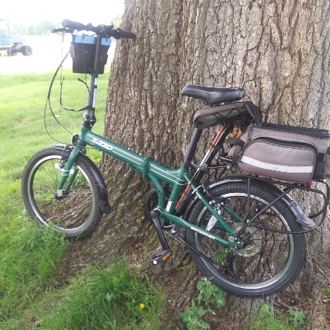

I finally figured out the picture resizing!
