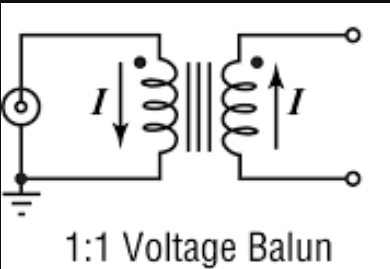

The impedance is an almost perfect match to 50 Ohm so it can be fed with a simple 1:1 BalUn (a w2du choke/balun will do fine at V/U, elsewhere a voltage balun will be ok for this antenna, see attached image)

the voltage balun below, will "float" the loop keeping it w/o a direct DC reference to ground the balun can be built using a binocular core
