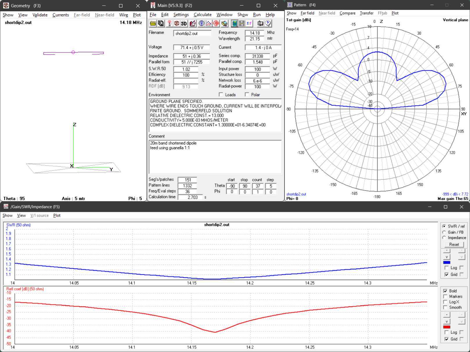

loading the model in 4NEC2 and running it results in something like this
notice that the impedance match is quite good and the bandwidth with SWR<2 is quite wide, the gain curve (not shown) is almost flat, offering more than 7dBi gain when (as in model) the dipole is raised at 0.6 wavelenghts
the overall span is about 8.17m or 26.8ft which may possibly fit some "critical" installations

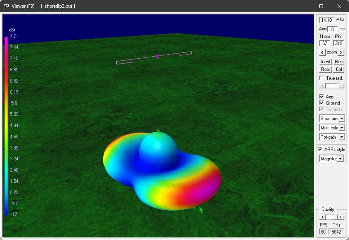

And here's the 3D radiation pattern, as you can see, it's just like the one from a regular size dipole
https://qrper.net/download/file.php?id=194
