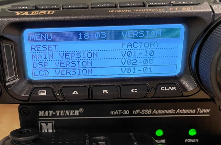

Also, I was checking the firmware on my radio and it left me scratching my head. Yeasu lists the following as the the latest firmware:
Main Version 01-09
DSP Version 02-04
LCD Version 01-01
However mine is shown below and appears to be versions that don't exist yet that I can find. Any thoughts? Do I have Beta firmware?
Main 01-10
DSP 02-05
LCD 01-01

On the firmware question, I found on an FT-891 group that newer radios are shipping with that firmware version, but it is not generally available yet. So that solves that.

As far as your firmware editions, are you from the future?? :lol: I should go check mine, I've never updated my 891.
