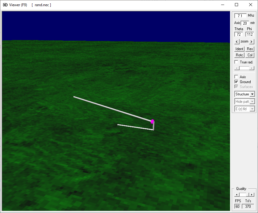

Let me try modeling the 71ft in NEC; I'll assume that the feedpoint is at 2m from ground and that the antenna is sloping up with the far end at 6m from ground (if the setup is different I may model it, just holler :D) ... anyhow, with such parameter, running a quick NEC model of such an antenna and running the optimizer to get a good counterpoise length value shows that a good counterpoise may be 11m (36ft) long, the config I tested is the following one

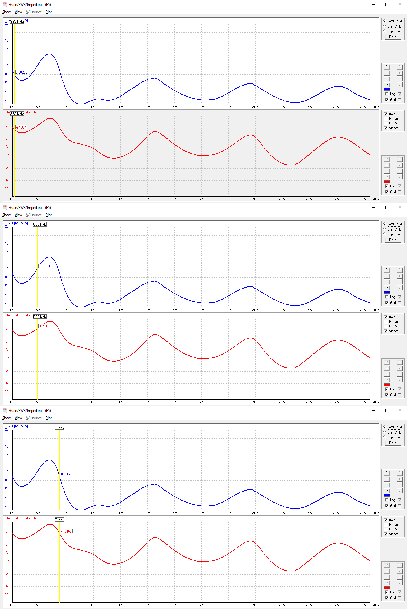

the "violet" dot is the feedpoint, as you see the antenna is sloping upwards as described above, while the counterpoise drops down on ground and then is laid out on ground, with such a setup the simulated SWR curve shows the following
and is quite promising, the highest SWR (above 10:1) is around 6MHz but, with that counterpoise, the antenna shows acceptable SWR on the bands from 80m to 40m, then the SWR curve lowers and the tuner should be able to easily find a match, again it's just a simulation, so all it does is giving us a starting point, but then some experimentation/testing will be needed, so my humble suggestion is to test that counterpoise at/near home and then play a bit with the length until you'll be satisfied, again it isn't "exact science" also since we aren't dealing with a resonant antenna, what we need is a low impedance path to allow return current to flow
