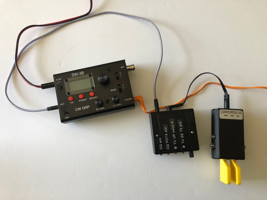

One recommendation: The SW-3B has only one memory slot and it's kind of a pain to use. In addition, changing the key speed is a pain. I solved both problems by buying and carrying with me a picokeyer. It's got 4 memory slots and a knob in the front to change key speed. The kit is a cinch to build (took me about an hour). It only weighs an ounce or two and it's just a couple inches square. It's even a great choice if you've never built an electronics kit before and would like to give one a try. You can order the kit here: http://www.hamgadgets.com/ULTRA-PICOKEYER.

Skip K4EAK, a question on the pico keyer....how does it interface to the SW-3b? How does it "override" the SW-3b keyer speed? Does it just act as an external iambic keyer and allow use of the external memories? I'm an older ham and haven't built a kit in years and eyesight is not as good as once it was. But as I renew my interest in ham and get involved in QRP, I might indeed want to take on a simple kit project.

It's kinda hard to explain, but the picokeyer translates your paddle presses and makes it look like perfect straight key sending.That's the first half of the process. The SW-3B senses whether there's a straight key or paddle attached to the key input when you turn it on. (I think it has to do with whether the tip and ring are shorted.) Since there's no "key speed" with a straight key, the SW-3B's key speed gets bypassed and it's the picokeyer's key speed that controls. So, the net process is that the picokeyer takes your iambic input and makes it look like a straight key output, the radio takes it as a straight key input and passes it through. (If you understood a word I just said, it'll be a miracle.K8RBV wrote: ↑Wed Jun 01, 2022 4:37 pm Thanks again to everyone commenting on the SW-3b. Very helpful info on LiFePO4 batteries. I'll have fun putting together my own go bag.

It's much easier to show than to explain. There's just a short stereo patch cable that runs from the key to the picokeyer and a short stereo patch cable that runs from the picokeyer output to the SW-3B key input. Here's an image. Everything is automatic. Just run the cords and have fun.

Perfect explanation and thanks for taking the trouble not only to explain, but to provide the photo ! Sounds like a perfect solution. And btw, I am just a little bit older hi hi.
