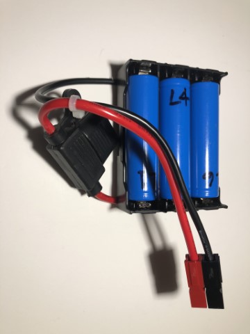

I thought about it, but went with Li-ion instead. I can get 3 Ah out of a little holder that's about the same size as a 3-pack of AA batteries, which is good enough for my little SW-3B rig.
3 Ah Li-ion Battery Pack
IMG_2810 (Small).jpeg (36.37 KiB) Viewed 14222 times
I guess all batteries with Li chemistry have special handling requirements, but Li-Po ones seemed more foreboding than the other chemistries. Hence my preference for Li-ion. I'll be curious to see what other say.

Just to be clear, these homemade packs don't have a BMS (although I suppose one could be added). Instead, I just take the batteries out and charge them in a four-slot lithium battery charger. The upside is that these 18650 batteries cost less than a couple dollars each, which means a 3 Ah pack runs about $5 total.
