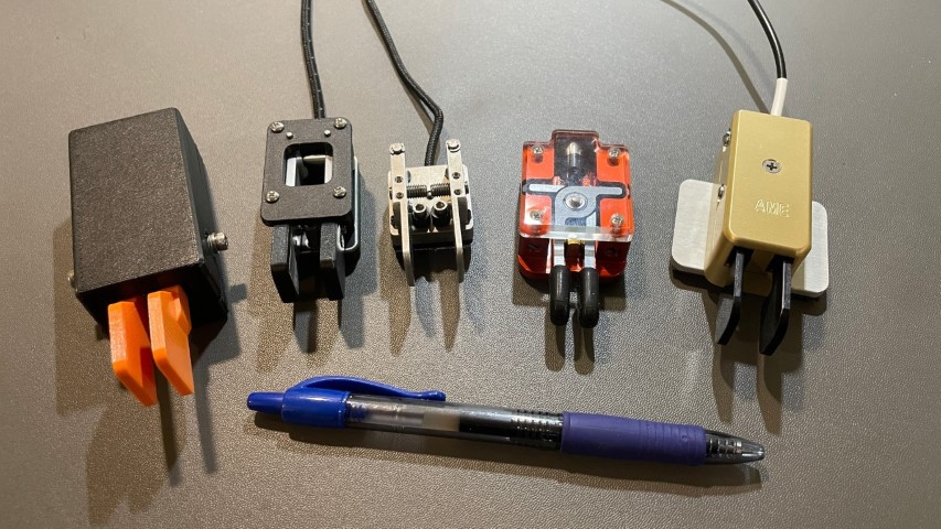

I love the SP4 paddle... Some wish it had a 3.5mm jack, instead of the cord... but I'm happy with it. I own Palm Mini & Pico, a TP3, and several American Morse keys & paddles. The SP4 is what I'd reccomend. If someone made a 3D printed fist handle, I'd but it, given it's small size, and my keying style.

by K4RLC
Hey Douglas - Vy nice key collection. What is the key that is 2nd from right, the one with orangish quadrants ? Interested in that one. TNX K4RLC Bob
Re: CW Morse SP4 paddle
Posted: Tue Aug 22, 2023 2:35 pm
K4RLC wrote: Tue Aug 22, 2023 2:00 pm Hey Douglas - Vy nice key collection. What is the key that is 2nd from right, the one with orangish quadrants ? Interested in that one. TNX K4RLC Bob
The second key from the right is a BaMaTech TP-III. https://www.bamatech.net/morsetasten/ba ... y-rot.html
