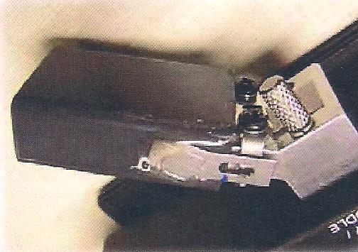

i converted it by adding an exoskeleton case over it.
i found an old 9V Nicad plastic battery case that fit right over the KXPD1. i epoxied an Exacto blade to the top and added a hook on the top of the Paddle mount. Then a rubber band held it in place.

Here is a close up of the 9V battery case on the KXPD1.
Paul w0rw

Additional info on the KXPD1 picture.
The top black screw has a small terminal lug under it that is trimmed to make a pivot peg for the Exacto knife blade.
The Exacto blade is epoxied to the 9V battery case and the Exacto blade hole slips over the pivot peg.
You have to add a few pieces of card board or foam shims inside the plastic case to get the side to side spacing correct.
