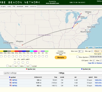

I finally got out to the park for first time this summer. I only had my homebrew QRPp rig, an EFHW cut for 40m and a 9 v battery.
I did work one of the 13 colony stations, but everything else was just hits on the RBN.
I need to get out with the analyzer and find the other

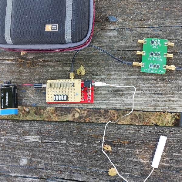

With this setup, my big goals are simplicity and very small size. I want everything to fit into an old eyeglasses case, including the antenna. I want
to pull it out of my pack and be on the air in minutes. And it needs to pack up in minutes.
I'll find the resonant points on the wire and put knots there so I can wind the wire out to just that length. A real "manual" antenna tuner!
The battery and key will be permanently mounted, so nothing can be lost or forgotten. The whole thing will be easy to carry and ready to go
whenever and where ever. I'd like the low-pass filters to be onboard also, but the switching gets to be big and messy
I also have the Zachtek flea transmitter that I could use. It has variable tuning, and the low-pass filters on board, but it only does 20, 30 and 40
meters. The antenna for it would be very simple. It won't quite fit in the eyeglass case either. It would be great if it did 40, 20 and 15. One antenna for everything and no links or traps.
Verticals means messing with masts and counterpoise wires. That means more work and time. I'm trading some efficiency for convenience and weight.

The whole setup, except for the LPF is home brew. Antenna, radio, crystal switching board, even the key. My goal was to show what I was doing.
I wasn't asking for suggestions to improve it or to build my own stuff. I can look up internet posts and repost them also, but I would much rather see what you're DOING.
