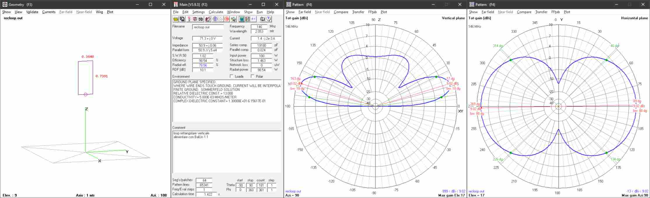

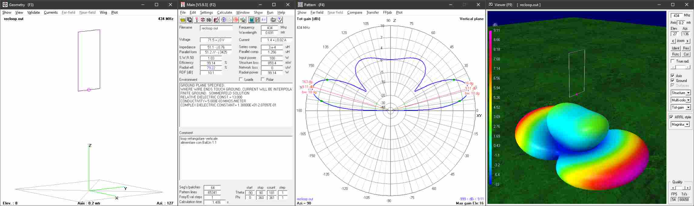

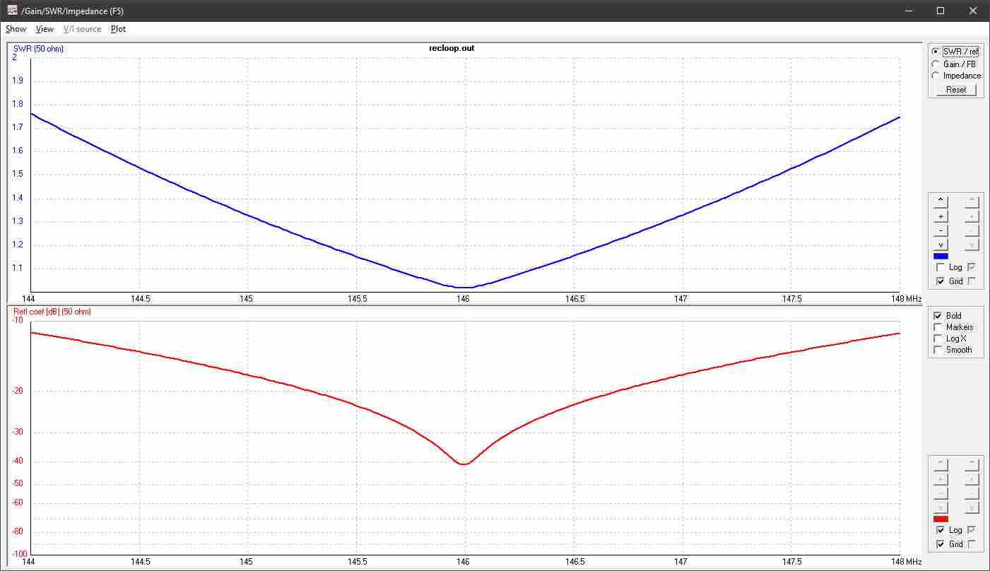

Just in case, the images below shows the "oblong loop" recalculated for the 2m band, sizes are in metric units, the model is for an antenna built using teflon insulated copper wire with 1.5mm diameter, and they should be used as a coarse indication, recalculating them won't be a problem, I think
download/file.php?id=180
the antenna is calculated for a centerband of 146MHz and the "SWR bandwidth" extends from below 144MHz to above 148MHz with a bidirectional lobe offering a gain of more than 9dBi and low takeoff angle
download/file.php?id=181
it may probably be built using the same approach of the one used for the J-Pole but offering much higher gain, although it won't be omnidirectional like the J-Pole, but that could be an advantage, I think :)
