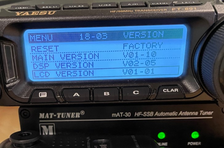

Also, I was checking the firmware on my radio and it left me scratching my head. Yeasu lists the following as the the latest firmware:
Main Version 01-09
DSP Version 02-04
LCD Version 01-01
However mine is shown below and appears to be versions that don't exist yet that I can find. Any thoughts? Do I have Beta firmware?
Main 01-10
DSP 02-05
LCD 01-01
Re: Question for FT-891 users
Posted: Fri Aug 05, 2022 5:05 pm
On the firmware question, I found on an FT-891 group that newer radios are shipping with that firmware version, but it is not generally available yet. So that solves that.
